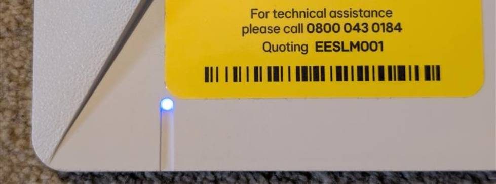

  3. Now, switch the case on by pressing the power button. The light will go blue when the unit has enough power to switch on.
    Even if you don’t intend to use the case immediately, we recommend switching it on to ensure it connects to the EE network. It can take up to 5 minutes for the case to connect to the internet and be ready to use.

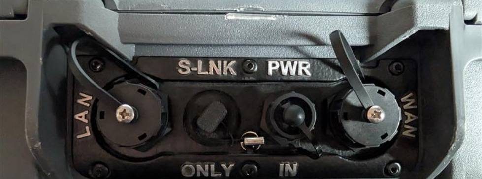

How to charge your EE Rapid Connectivity Case
Rear of Rapid Connectivity Case showing ports
  1. First, open the PWR cap on the back of the case by twisting it half a turn anticlockwise, then pull it towards you. This will expose a USB-C port.
  2. Then, plug the USB-C charger into the port and switch the mains power on. It should now be charging.
Note: the case is not watertight when its being charged.

Using the LAN and WAN ports
You can connect LAN (Local Area Network) and WAN (Wide Area Network) cables to your EE Rapid Connectivity Case via the LAN and WAN ports.
What the WAN port is for
The WAN port lets you connect the case to external internet networks, such as the Starlink Mini. If you’re only using our built-in EE cellular network, you won’t need to use this port.
What the LAN port is for
The LAN port lets you connect devices directly to the case using a wired connection. Most of the time, you can simply connect to the case via Wi-Fi. However, if your device needs a stable wired connection, you can plug it into the LAN port instead.
To connect a LAN or WAN cable to the case
  1. Twist the cap a quarter turn anticlockwise, and pull it out once its loose. This will expose the port.
  2. Push the cable into the exposed LAN or WAN port.
Note: the case is not watertight while a LAN or WAN cable is connected.
When you’ve finished with the LAN or WAN cable
  1. Remove the cable.
  2. Put the cap back over the port and gently push it in, then twist it clockwise until its secure.
The case should now be watertight again.

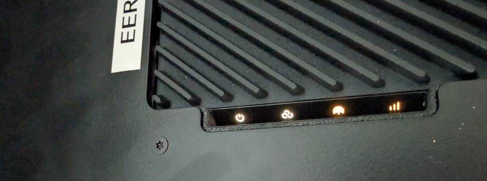

Lights on the EE Rapid Connectivity Case router
EE Rapid Connectivity Case, showing Power, Cloud, Modem and Signal Strength lights
You will find four lights on the router – the power, cloud, modem, and signal strength lights. Learn about them below.
For more information about the different lights and what they mean, check out the Understanding LEDs guide on the Enterprise Wireless Documentation Portal.
Power
  • Should always be white and solid when the router is powered on.
  • When powering up, only the power light will be on for the first few minutes (until there is an active internet connection).
Cloud (internet connection)
  • If it's white, the router is connected to the internet. When first turned on it can take up to 5 minuets for the internet to be ready to use.
  • If it's not lit up, it means there’s no internet connection.
Modem
This light indicates information about the integrated modem. Do not worry about this light.

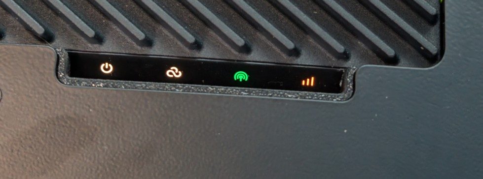

Signal strength
Light
Status
No light
No signal
Solid green light
Signal is excellent or good
Solid yellow light
Signal is fair
Solid red light
Signal is poor
If:
  • Your signal strength lights are red or not lit up
  • And you’re using our built-in EE cellular network and not getting a signal
 Try moving the case to a location with better EE coverage.

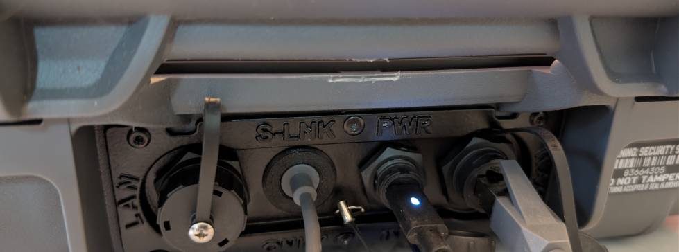

How to connect the Starlink Mini to your EE Rapid Connectivity Case
Rear of Starlink Mini showing ports
To connect the Starlink Mini to the EE Rapid Connectivity Case, you must:
  • Link the Mini to the case’s S-LNK port using the Starlink Mini power cable
  • Link the Mini to the case’s WAN port using the grey WAN cable
All of these ports can be found on the back of the EE Rapid Connectivity Case.
Note: the EE Rapid Connectivity case MUST also be connected to mains power for the Starlink Mini to work.
The S-LINK plug
The S-LINK cable pulls out towards you – to put it back, simply push it back into the port in the case.
